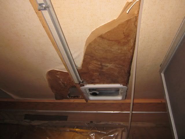

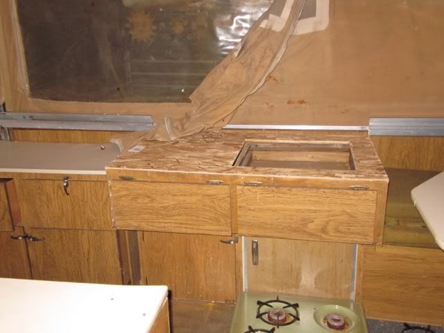

Gnarly old (and smelly) canvas, roof rot, floor rot, the whole works.
Ripped off the canvas and tossed it. Even the zippers. We just didn't have the energy to pull the zips to save and/or sell them. And since I'm going hard-sided, I didn't need them.

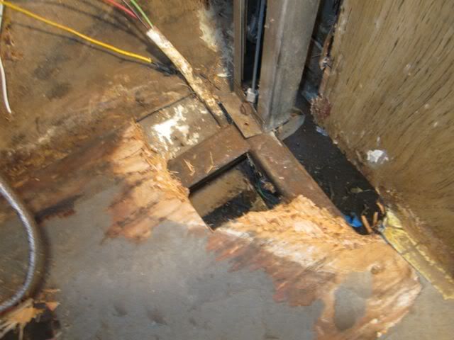

First up was the floor. After spray-bombing the underside and letting it sit overnight, I sucked up the battlefield of deceased black widows with the shopvac and got to work.
Icky floor is now patched.

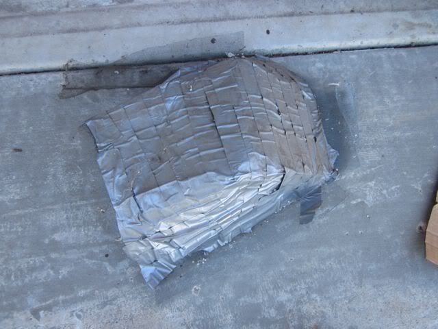

"high-tech" wheel wells replaced (yes, that really is chicken wire and duct tape.
Stage one of the new wheel wells.

Next up (and this is next week's project), comes the inside cabinetry/benches/sink/stove/wet-bath area.
