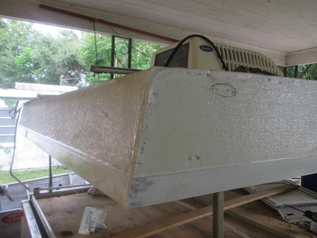

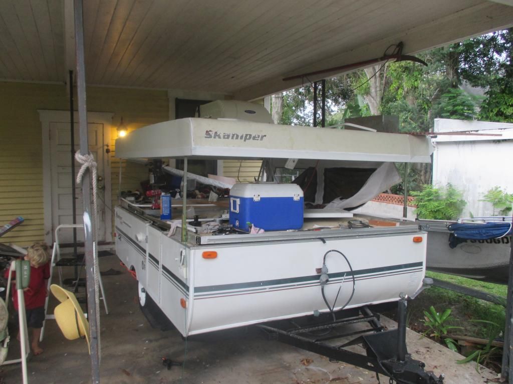

We'll I dove into our roof repair this evening, removing the rotted rear board. I have combed through the roof repair threads and still have a few questions.
1) I plan on using outdoor or marine ply but what is recommended to seal it? Spar varnish? Thompsons? etc..
2) What do I use to glue the wood to the fiberglass skin?
3) Does anyone sell new aluminum trim?

Update.... 14 days before our camping trip and I think I've got the majority of the rotted wood out. The roof and street side look ok. I ordered 5/8" marine ply that should be here tomorrow.

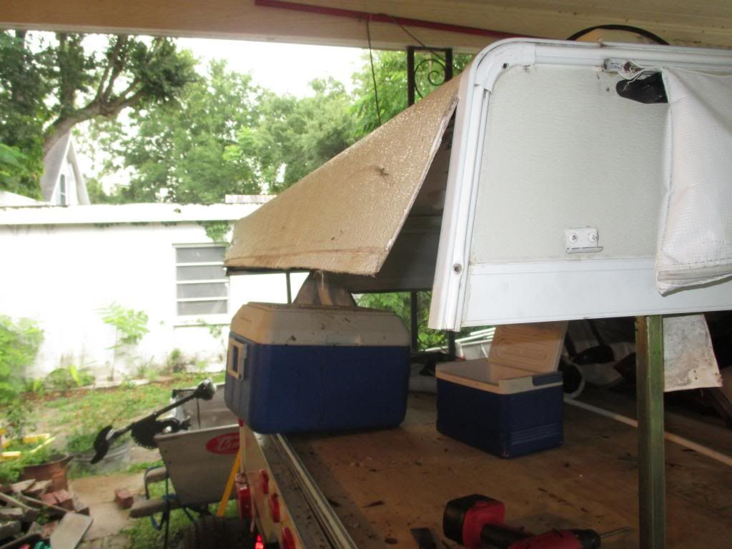

Jeepguy93 said:
Looking good!! Were your end boards glued to the aluminum skin???
Yes they were glued but the roof material is laminate fiberglass, which tore/cracked in a few spots. I'm using a die grinder w/roll lock and DA sander to remove the last bits of wood stuck to it. I would like to replace the skin but will just patch if I can't find a replacement.
I was planning on using 3M super 77 but am thinking I may need something stronger.
I picked up 5/8 Marine ply ($$ owch) and plan on painting it with oil based urethane porch paint.

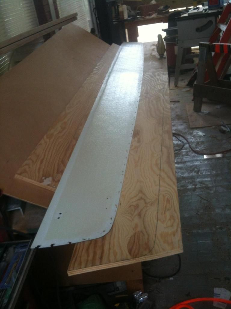

Here's a better pic of how I left it Monday night.
Yesterday I picked up and ripped down the sheet of 5/8 marine ply (I think it originally had 1/2" ply plus 1/8" ply). Once I got home I made up the end boards and today I made the splice for the side board.
Does anyone know where to find the laminated fiberglass for the roof?

Cutting a new side board;
and glued in place, what a job!
I did have a little trouble, hopefully the trim will cover it;
Now on to the 100's of little pieces parts!
