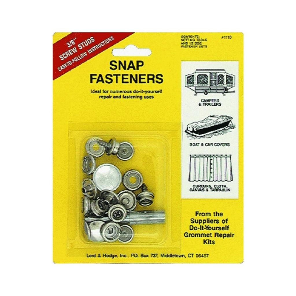

http://colemanpopupparts.com/products/shower-door-strap is close. You need a 3/4" canvass strap with some snaps. Mount one end to the ceiling with a male snap in it and put the female snap on the other end. This will snap on the snap on the end.
You can adjust the length after you mount one end to the ceiling. You want the door to hang level when the other end is on the bracket over the door. (You don't need the velcro piece shown. This is just for reference.)

We just had one break (the snap pulled through the webbing of the strap). I simply went to the fabric store, bought a heavy duty snap kit and a small piece of webbing. Cost? less than $9 Male end is screwed into the ceiling and on the door already. Webbing has a female piece on both ends. Just snap it in place. Easiest fix ever.
